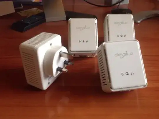

I have used Devolo dLAN 200AVs extensively in my UK home for about five years now, and they are great.
Devolo dLAN 200 AV
I have about six of them, all single Ethernet port (multiport versions, which three Ethernet ports, are available). I have not found this to be a problem, because I have switches/hubs in most rooms, anyway.
They have UK plugs, not US plugs, but none of my dLAN 200 AV devices are pass though (i.e. you can plug a mains device into them), so I needed either use an extension cable with a 4 or 6 way plug board attached, or where I had dual sockets in the wall, I just sacrificed an outlet.
The benefit of pass through devices, is that they contain noise suppression circuitry inside them, to help counter any noisy devices, or power on spikes that may be generated by adjacent devices that may also be plugged in to the plug boards. Devolo actually recommend that the dLANs are not plugged in to plug boards, and that they should only be plugged in at the wall, due to signal degradation. However, I personally, have not experienced many problems, mine all work fine.

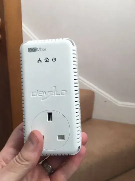

I recently added two 500 dLAN AV Plus devices, which do have pass through.
Devolo 500 dLAN AV Plus
I use these for a higher speed connection from my media server, in my garage, to my lounge, where the XBMC is, and I can stream videos just fine. They also are compatible with the existing 200AVs, so now every room is connected.
