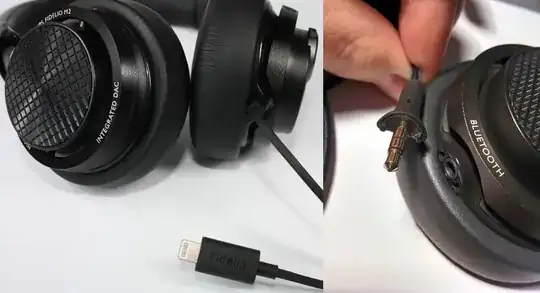

The headphones mentioned are the Philips Fidelio M2L (based on the inexpensive Fidelio M1 series) and the AMP/DAC/DSP Apple Lightning cable¹ for the Audeze EL-8 which has been offered with the closed back version in a titanium-colored variant for a few weeks. The M2L looks like it has no replaceable cable, here is a comparison with the M1BTBL:
Integrating the DAC into the M2L cable (or similar products) and putting a 3.5mm plug on the other end would be possible and great for compatibility² but increase the price of DAC replacement cables (you probably get a new Fidelio M1 for the price) and generate questions from customers who have unfounded doubts about the 3.5mm plug.³ Proprietary connectors on the headphones themselves are accepted for products in higher price ranges and ensure compatibility with a variety of jacks on different devices, but mainstream product designs seem to be increasingly optimized for incompatibility and obsolescence.⁴
