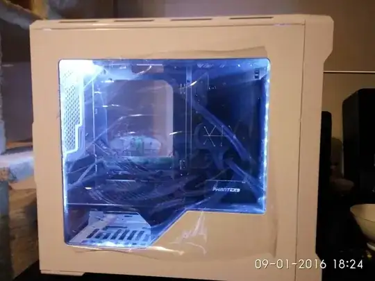

After using "Peter Zhu's" answer, I lit it with LED strips (3528, 12V, Color: Cold White) and below you can find a photo of it:
Phanteks Enthoo Evolv ITX (white) with cold white LED stripes
