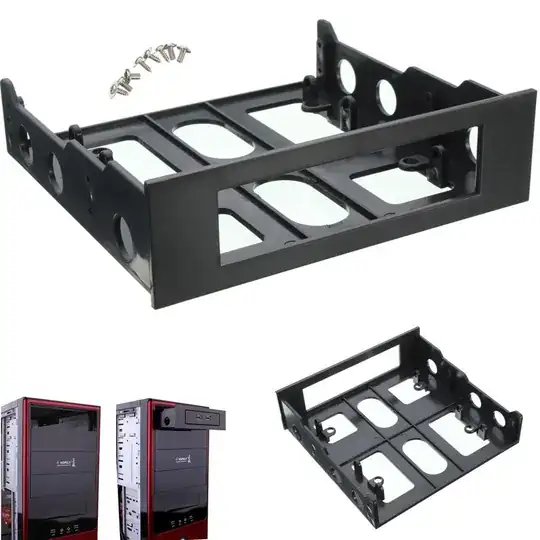

However, 3.5" -> 5.25" bay adapters are cheap and easy to find. With one of those, a $20 3.5" bay from Silverstone gets you four USB 2.0 ports, HD audio, and a FireWire port (or if you don't care about looks, $18 gets you the same thing in silver); $25 from Silverstone gets you four USB 3.0 ports and HD audio.

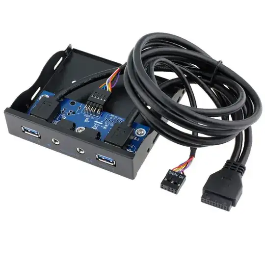

I'd try these ones from eBay:
USB 3.0 and audio front panel 3.5 to 5.25 drive adapter
The adapter is $3 the front panel is ~$11 although shipping usually is not too fast from Hong Kong.
I have a similar front panel (without audio). The USB 3.0 ports work well for me.
