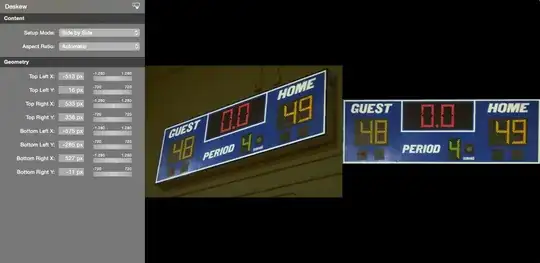

I am recording and streaming live from lecture halls, and I need to correct perspective to ensure that large blackboards are not distorted/skewed. As we are streaming multiple lectures simultaneously using automated systems, we cannot have a computer hooked up. So I am looking for a hardware based solution that perform the the same as mimoLive’s “Deskew Filter”.
mimoLive
Searching the internet I have only found one solution (AlphaEye) for this, but the company does not exist anymore. The video feed is an SDI signal, but a solution for HDMI or RTSP would also work.
