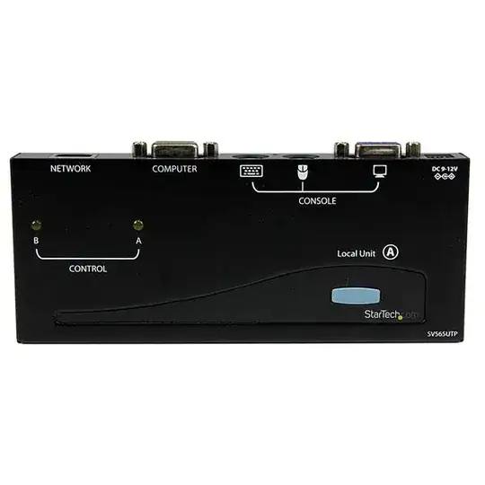

Another option, for even longer distances, is a KVM over CAT5 extender. Startech has many options, among other vendors. I'd search on Amazon as the prices are generally better than buying directly from Startech.
For example, the SV565UTP (they are sold in pairs):
You take one and put it next to the computer and connect it to the machine's keyboard, mouse, and monitor outputs. You take the other one and plug a keyboard, mouse, and monitor into it. Then you run a CAT5 cable between them and you get up to 500 feet.
They make longer distance ones; there's a 650 ft VGA/USB extender, there's a whopping 1500 ft DVI/USB extender, and so on.
These are overkill for your 55 ft in terms of cost, but if you need even longer runs, or you have the budget, they're a good option. It's a lot easier to run CAT5 through walls and such than VGA / DVI, too, and cheaper to replace failed cables (or re-terminated failed connectors). If the building already has CAT5 wiring for ethernet you may be able to repurpose one of the existing runs. If you already have a network closet with a patch bay for wall jacks around the building, it also makes moving your console around in the future pretty trivial.
