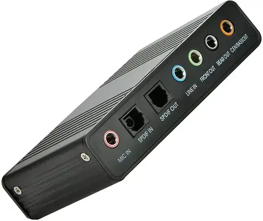

My recommendation would be a full external soundcard that has line-in support, that is not super big.
The best I can do that actually does have a line-in and is more or less plug-and-play is this:
image https://www.amazon.com/Optimal-Shop-External-Recording-Compatible/dp/B07BGS2BS1/ref=sr_1_35?dchild=1&keywords=usb+sound+card+line+in&qid=1629833572&sr=8-35

  • Yup. I've a few of these with different plug configs. They're cheap as chips, maybe 10 - 20 bucks/quid/euros. They 'just work' because the chipset design was perfected 15 years ago or more & so cost nothing to make. You're pretty much paying for the metal box;) – Tetsujin Aug 24 '21 at 16:02
