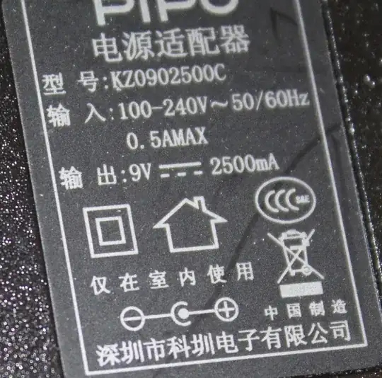

Here are some pictures of the port on the tablet as well as the power adapter it came with showing its specs:
A cropped image showing the label on the power adapter that came with the tablet: Power Supply’s Label
The contents of the label transcribed:
型号:KZ0902500C
输入:100-240V〜50/60Hz
   0.5AMAX
输出:9V ⎓ 2500mA
where 型号 = Model, 输入 = Input, and 输出 = Output
(The character between '9V' and '2500mA' is U+2393 DIRECT CURRENT SYMBOL FORM TWO. If you can’t see it, it means you don’t have a font installed containing a glyph for that codepoint. If that’s the case, I recommend installing a font like Everson Mono, STIXGeneral, or Symbola, which does contain a glyph for it).
An image showing the DC 9V port on the tablet: DC 9V Port on Tablet
And here’s an image showing the entire power adapter (might not want to click on that link though… it’s an uncropped 20 MB picture of the power adapter that came with the tablet that I only bothered uploading since you can also see the barrel connector).
