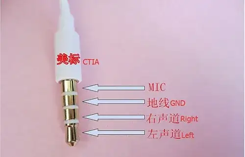

Skyfellow
As per this picture top to bottom = MIC at the Top, GND, Right, with Left at the bottom = CTIA
I will refer to them a Top, 2nd, 3rd, Btm respectively. also the measurements I show are from a RIG 300HX (xbox version, Xbox is known to be CTIA, so plugging in and testing your headset(gaming) on an xbox controller may also prove it.
Using a good multimeter, choosing the best range on your meter, for each connection, to find the most accurate answer for each measure.
measure: Top-->2nd = MIC ohm might equal 50-20000 ohms
  • for me:
  • Top-->2nd = 8000 ohms
now measure 3rd-->Btm
  • for me:
  • 3rd-->Btm = 320 ohms,
  • each ear (L&R) should be half, or 160 ohms in my case.
at this point we still do not know which is ground, but what we do have is the total impedance
  • MIC-->Btm = 8160 ohms
so now you will do 2 measurements
  • Top-->Btm
  • 2nd-->Btm
whichever is equal to half of 3rd-->Btm
  • = (3rd-->Btm)/2
  • will be the GND
In my case:
  • 2nd-->Btm = 160 ohms
  • so 2nd=GND meaning I have CTIA
if Top-->Btm = (3rd-->Btm)/2, then you have OMTP
Here are my measurements:
  • MIC-->GND = 8000 ohms
  • L-->MIC-->R = 320 ohms
  • GND-->L = 160 ohms
  • GND-->R = 160 ohms
  • MIC-->GND-->L = 8160 ohms
MIC-->GND-->L means because MIC is connected to GND internal and so to is GND to Left/Right speaker, when can measure across MIC-->L/R to get a max reading.
Your readings may vary, but apply the same math and you should be fine.
