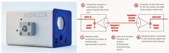

BlackBox offers professional radio bridge links, but you are not limited to radio: A no-license-required infrared laser bridge can provide one or 10 gigabit/second of bandwidth as described at https://hackaday.com/2016/03/10/gigabit-ethernet-through-the-air/ , at http://www.koruza.net/features/ , and http://quickstart.koruza.net/ for less than two thousand Euros (VAT & freight not included).
Run a gigabit or 10 gigabit LAN connection to a point on walls which face each other. You can use power over Ethernet or bring out a 24VDC connection capable of 6W of power.
Mount a two kilo, 18 cm x 12 cm x 12cm, Koruza box on each wall.
Diagram and photo of Koruza infrared laser optical bridge
Align each laser to point at each other with the green laser included.
Then, turn off the aiming laser, and the eye-safe infrared laser in each Koruza box will connect through snow, dust, rain, and fog.
