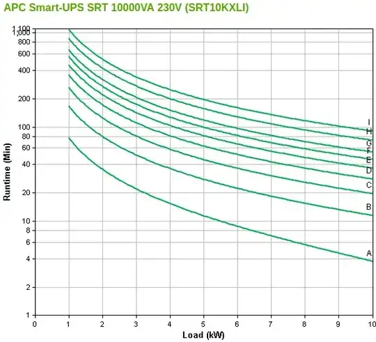

Which means a 1,000 W computer needs a UPS which can briefly deliver 2,000 W, but we can estimate its running time at 500 W.
Because of the non-linearity, most UPSs are specified by peak load, and have a load-vs-time calculator or graph. The following graphs show a 10 kVA UPS (curve A) and the same one with various additional batteries which give longer times.
From APC datasheet

An UPS with external, adequately-sized batteries. You may opt for a commercially-available or a hand-made hack.
For off-the-shelf solution: manufacturers like to advertize "optimistic" (read: unreal) runtimes. In order to get the real picture, see the ratings of the spare batteries, multiple V to Ah numbers and allow for at least 50% age-derating of the batteries.
Lithium batteries: an overill. Expensive as hell, yes, long-lived (do you expect to run the same setup in 10 years?) and after these 10 years you won't find a replacement. Lead-acids are a commodity and even if you fail to find an original replacement batteries, you can still disassemble the packs and fit a standard pieces there.
What I did (for about 40 remote offices): APC-1500-SMART-something, sent its internal batteries for recycling and had the electrician to connect it to a pair of truck batteries (12v, 230Ah) connected in series in order to get the required 24v of the original battery pack. The batteries need to be replaced after ~5 years if you still want 4 kWh out of them (in my case the improved electrical grid and replacing the equipment with more energy-efficient allowed more than 10 years of use). Bonus: every truck driver knows where to get them for cheap and how to replace them.
