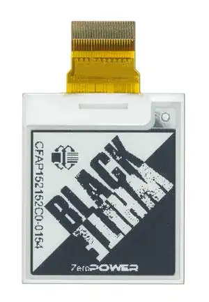

Your objective may be resolved with a device known as an e-paper kit.
e-paper kit
The one in the image above is 154 pixels square, qualifying for your low-resolution requirement. There are other sizes on the market, other resolutions and a wide range of costs. The one in the image is priced less than US$10.00. It's uncertain what you consider to be low-cost.
You should be able to find that you can purchase a processor such as an Arduino or Pi or adapt your current source to the product you select.

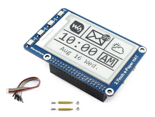

Amazon sells a hat for a Pi at a bit higher cost than the above device:
Amazon Pi Hat for e-paper
