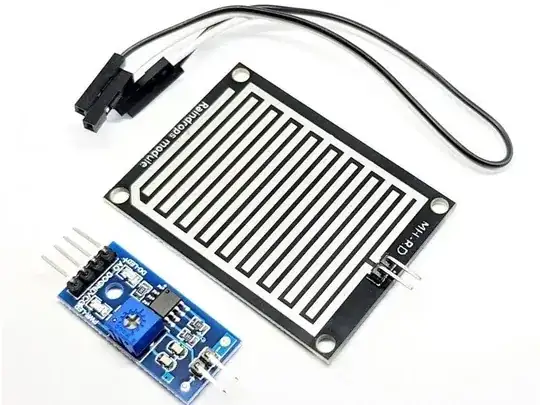

I am thinking of creating a device that will detect water leaking/ water detection. I am currently using this: enter image description here

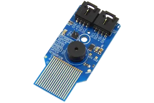

And this one I want but it is costly and not available on Amazon India or flipkart : enter image description here
I don't know if there is a small alternative for water detection as good as them. I tried searching but what I am getting was these sensors. So if you guys know any small size sensor to detect water presence please let me know. And if it comes with buzzer it will be a lot of help.

The sensors shown are simply conductors separated by an insulating space. When water, which conducts electricity slightly when pure (or much better with dissolved ionic substances), bridges the gap, it completes the circuit. All you need are two conductors, separated from each other by an insulator such as air, PCB plastic or cloth.
If expense is a priority, make your own. Just weave two bare copper wires in parallel through a piece of nonconductive material such as nylon fabric. You can customize the size, flexibility and other qualities to your needs. For a bed-wetting or diaper sensor, use thin wires and material for comfort, going to two heavier ones for the connection to the rest of the circuit, for strength. For a diaper alarm, just put the sensor in an are likely to get wet; there's not need to wrap the whole diaper. BTW, disposable diapers contain absorbents that prevent the outside from getting wet, and I do not suggest putting a sensor inside, against a baby's sensitive skin. Ummm... and sterilize the sensor after use with bleach or hot water.
The solid PC boards you show might be more useful in detecting water on a floor or window, though.

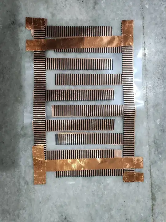

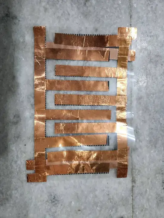

I made a diy flexible sensor for diaper-free time - not exactly what OP asked but still might be helpful. You can make it smaller with thinner tape and sheet but still probably not comfortable/usable within diaper. (Side note: Good diapers actually have wet color-changing strip on them, which is much more practical. You can just replace them every 3-4 hours or look at the strip.)
I used adhesive copper tape (2cm wide) to make the rain sensor-like pattern on top of OHP transparent printing sheet. I also printed out the pattern on OHP sheet to help lay out the tape (visible from back). This makes for a nice large A4-size sensor which is flexible, waterproof and not easy to tear. Then I use 2 alligator clip to attach to 2 rails and connect to mcu. It would be nice to upgrade to a single clip with 2 connectors to make it quicker to detach.
One issue I noticed is that human body resistance can also trigger false positive if you sleep directly on it (think of resistance of skin between two closest fingers of the sensor, not whole body resistance). Rather, I use a super-thin 20GSM hospital/salon-purpose bedsheet which is laid out on the sensor and lay the baby on this bedsheet. Because it's very thin and absorbent, as little as 3 drops of water easily soak to the bottom side and activate the sensor while increasing the non-wet resistance to infinity (beyond multimeter measurement). It's also more comfortable to sleep on.
Front side - Front side
Back side - Back side
