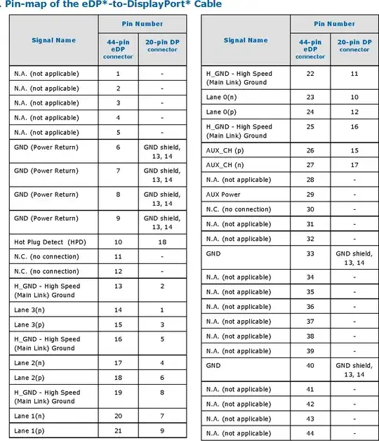

Edit: I have found an eDP to DP cable pinmap.
  • Is just mapping the pins enough ?
  • Are there any other variables to consider, like power supply ?
  • Will there be a loss in quality depending on the length of cable ?

  • I'm finding lots of stuff to go the other way, to use an eDP panel with a regular DP input. I can't find any ready-to-use product that does the other direction. I am finding several DIY discussions about wiring an eDP output into a DP input; It is possible and only a specific subset of pins need to be connected for the video signal. eDP has a lot of other functionality that DP does not. – Romen Jan 21 '20 at 15:25
  • @Romen Thanks for your reply.
    I have found an eDP to DP cable pinout (Edited the question to add the image). Is just mapping the pins enough ? Are there any other variables to consider, like power supply ? Will there be a loss in quality depending on the length of cable ?
    Also, can you provide the link to the DIY discussions you found ?
    – Idk Jan 22 '20 at 08:42
