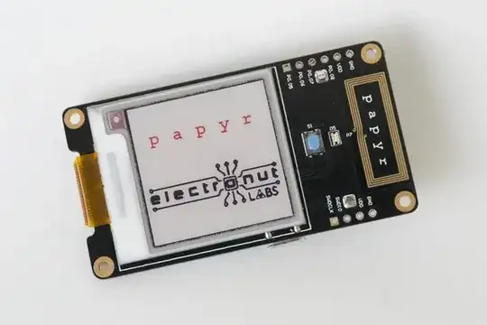

So, I just found Papyr.
Hardware Specifications
Raytac MDBT50 module with Nordic nRF52840 BLE/802.15.4 SoC
1.54 inch 200x200 pixel red/black/white epaper display - GDEW0154Z04
CR2477 coin cell holder
Micro USB (device)
RGB LED
NFC (PCB) antenna
Push button
USB/Battery power switch
Extra GPIOs
SWD Programming header
Mounting holes
