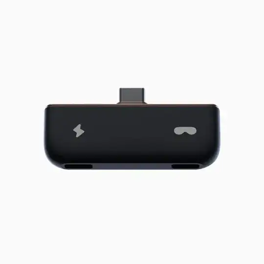

This exists, but there aren't a lot of options. Most of them were originally intended for using AR glasses with your phone, but have been repurposed for normal external displays.
Rokid Hub - $99
It's cute and does exactly what it says on the tin! However, it's $99, and out of stock everywhere, with no timeline on it being back in stock.

    This is great, thank you! I've found the Rokid one on AliExpress (it was €36 delivered, but is now showing as €45) and am looking forward to trying it out soon – Aaron F Jan 29 '24 at 18:15
  • The Rokid HUB arrived today, and it doesn't work :-( It tries to: the steam deck power light turns on, the external display flickers for a moment while the steam deck display goes blank, and then it just returns to normal as if nothing's plugged in. I tried with a Surface Pro 7 and it enters into a loop of switching to the external display briefly and then back to the Surface display. There must be something that the VR glasses do which my display doesn't do. I'm going to try and buy one of the other options now. The hunt continues – Aaron F Feb 05 '24 at 18:22
    I spoke too soon! It works if: you plug everything in while the Steam Deck remains in standby mode. It unfortunately covers the power button, but if you use a toothpick (this is why I hadn't tried this combination before) then you can press it. Then the deck's screen turns on for a few seconds, then turns off for some more seconds, and then the external display turns on... and stays on! \o/ – Aaron F Feb 05 '24 at 18:31
    Oh wow, yeah I didn't think about it potentially covering the power button. Glad it worked out though, even if it does require a toothpick! – JMY1000 Feb 06 '24 at 00:33

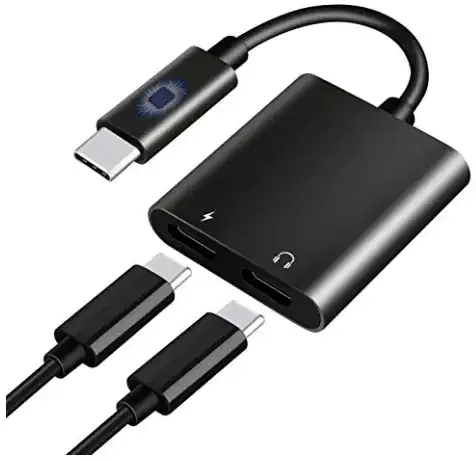

EDIT 7/5/2020: It has been brought to my attention that this device only supports audio.
I think a device like this 'Twinkk USB C Splitter' is what you're looking for.
It costs $15.99 and allows you to charge your device while also plugging in a data connection (In this case, your ASUS Zenscreen) at the same time.
