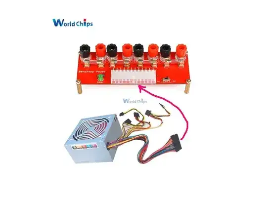

  • Except for #2 a standard ATX power supply for a PC. If you can find a small PCB with screw adapters, you can cut off the molex/sata end solder them to the PCB. Short the 2 pins together on the ATX 20/24 pin plug and you have power. – cybernard Nov 13 '19 at 18:09
  • @cybernard: you may consider posting that as an answer, since it is one. – Arseni Mourzenko Nov 13 '19 at 18:11

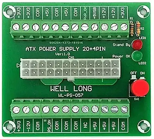

I know this adapter is $10 + $3 shipping and handling, but it works with any ATX PSU. enter image description here
https://www.amazon.com/20-pin-Supply-Breakout-Module-terminal/dp/B07KDX5CK8
So that plus the PSU could put you slightly over the budget, but you can re-use the adapter on any future PSU.

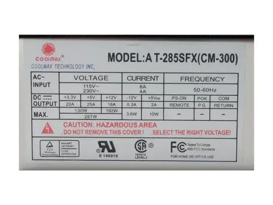

This one has 2 12v which combined would be 29A
https://www.newegg.com/p/N82E16817159046?Description=power%20supply%20atx&cm_re=power_supply_atx--17-159-046--Product
