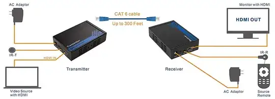

I know you were more interested in a wireless solution, but if you decide to go the wired route you can use an HDMI over Ethernet Extender. With the Cable Matters Extender, you can achieve 1080p @ 60hz with a max range of 300ft. There are other manufactures (such as IOGear) that make the same type of device, including 4K versions.
https://www.amazon.com/Cable-Matters-HDMI-Extender-Ethernet/dp/B00OZV04BK
