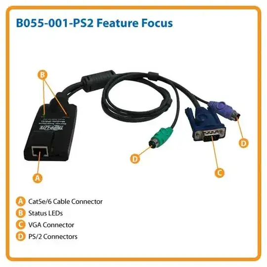

You want a KVM over IP device.
Something similar to TRIPP LITE B055-001, would work (assuming, in this case, the server has PS/2 ports for the keyboard and mouse). This model is about $120.
TRIPP Lite B055-001
There are USB enabled ones as well, such as the StarTech SV5USBM, which has only one USB connection. Adding on more connectors raises the price from about $100 to almost $320
Note: I've not used these specific devices. They appear to be marketed toward consumers, directly, versus the KVMIP devices I've used in a data center that cost between $2-3K each.

  • Does this make it available over the Internet or just extend the range of your keyboard, mouse, and video? – adam0101 Nov 09 '15 at 16:55
  • It makes it accessible via the network. With the right network management, it is accessible via the internet. – Andy Nov 09 '15 at 16:56
    I've used similar devices (with a KVM switch), so I thought Andy's cheaper solution was interesting. I did some research to see if it will actually work. Unfortunately, the RJ45 ports on those modules are not actually network interfaces (notice that lack of a link light and MAC address). Sadly, those modules require you to own their respective Cat 5 IP KVM switches. The Lantronix SLS200USBX0-01 SecureLinx Spider that he mentions, however, will work, though it is currently cheaper on Amazon. I believe the second USB port is actually for power if needed. – JTL Nov 11 '15 at 14:49
