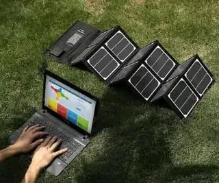

I'm based in a country with an unreliable power supply but good sun with a setup that can keep my portable PC charged for about 7-8 hours a day without going to too much trouble. While the exact product I use costs more than your $200 budget, I'm assuming you won't be putting in a full day's work while camping, and there's a lower-power option that should give you a few hours laptop use and a charged USB device on a sunny day that is within your budget.
< $200 option
Poweradd 40 watt Solar Charger, currently $159.99 (it says its on sale from $499.99 but I'm skeptical, there was a similar discount in June last year when I bought my 60 watt).
I recommend PowerAdd's panels because they're high efficiency, very portable, durable, and have some basic voltage control built in, at 18 volts which is suitable for most laptops and battery packs, with optional USB output too straight from the panel. They have both DC output (for a laptop or battery pack) and USB output, and can charge both at once (though obviously both will charge slower). Unlike most regular solar panels (not counting expensive kits like GoalZero's) they're explicitly designed with this kind of use in mind, and come with a variety of laptop and USB device adapters (basically everything except Apple adaptors which need to be bought separately). The 60W even comes with a jump lead and can jumpstart a car (though it looks like the 40W doesn't).
I've been using the larger ($259) 60 watt version almost daily for nearly a year now. It's very portable - folds down to the size of a hardback novel, and weighs about the same. It's sturdy, too, and flexible, with a bit of give and bend, and a waterproof canvas. It's survived a tropical rainy season (I kept it out of direct heavy rain but it took plenty of splashes and humidity, and some light rain) and a very dusty atmosphere. The 40 watt will be even more portable, and looks just as sturdy.
There's a bit of an art to setting it up such that it points the right way and also keeps whatever you're charging in the shade - I recommend something like washing line or (what I use) bungey cords with carabiner clips.
Update: the solar market is fast moving and it was over 6 months ago I first looked into this, and since then several new products have appeared that seem to offer the same power and features as the 60W version at the price of the 40W version, from KingSolar (15V), Suaoki (18V) and ALLPOWERS (18V). I know from direct experience that the 60W PowerAdd I use is good, if these are as reliable, they're great value. 40W should be enough for occasional use while camping, 60W will easily be more than enough in an sunny location.
