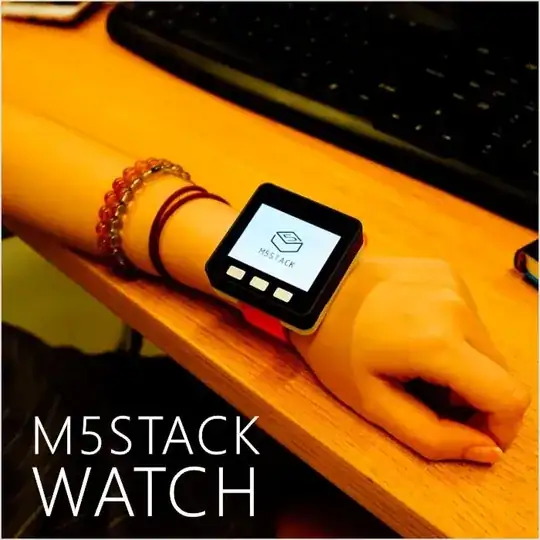

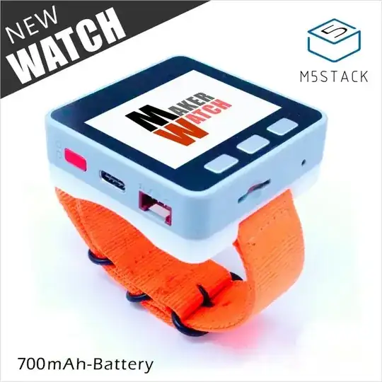

So, for US $14.90, plus postage, I found this:
M5Stack Multi-function Watch! With 700mAh Battery for Arduino & Micropython ESP32 Core Intelligent Programmable Watch with Band
It's slightly chunky, and I don't like only having a 700 mAH battery (but the ESP32 has great power management), but it's more than good enough for development.
Hmmm, the Google cached version of the page shows it as costing less ($10.70), with a batter (850 mAH) battery. Strange days indeed!

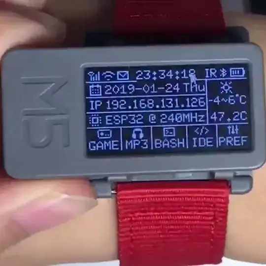

Also,this one looks smaller, with a better form factor. I will have to enquire where to but it & update this answer. enter image description here
[Update] from forum.m5stack.com/topic/548/m5stick-watch/9
the original stick can be purchased via the following links: https://www.aliexpress.com/store/product/M5Stack-Official-New-M5Stick-Mini-Development-Kit-ESP32-1-3-OLED-80mAh-Battery-Inside-Buzzer-IR/3226069_32994893797.html?spm=2114.12010615.8148356.13.25ba781bqWZV2X
https://m5stack.com/collections/m5-core/products/m5stack-official-new-m5stick-mini-development-kit-esp32-1-3oled-80mah-battery-inside-buzzer-ir-transmitter-mpu9250-optional
The main differences between the stick and stick c are that the stick c has a smaller screen but it is color opposed to the monochrome oled of the original, the power management chip is different, there are a bunch more sensors added etc.. for a detailed comparison you can check the docs pages for both the stick and the stick c
https://docs.m5stack.com/#/en/core/m5stick https://docs.m5stack.com/#/en/core/m5stickc
Also costs sub $15
