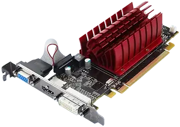

I have a low end Radeon card in one of my closet machines. If you are getting a new one, I'd recommend the Radeon HD 5450. It is $30.
Radeon HD 5450
It has support for HDMI, DVI and HDMI output. It also has 1 GB of memory and has a PCI Express interface. It is also fanless.
It's not going to run high end video or play the newest games at max settings, but it will run a high definition monitor without a problem.
Update: For next generation (6xxx) of the same graphics adapter, go with Radeon HD 6450.

  • This is a decent suggestion (+1) although it is not really what I had in mind -- I'm already aware of the bottom end 3D cards (a 5450 based card on newegg.ca is still >= $40). I've clarified the question by introducing the issue of power consumption. I am sure it is possible to make a 16 MB card with a GPU that requires no cooling or heatsink at all (think tablets). – goldilocks Nov 03 '15 at 16:31

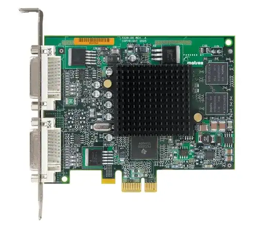

You're going to end up getting something older. Pricerange though... hard to match.
I can think of something that would tick off most of the boxes - a Matrox P690 (I was thinking the G550, but no WDDM drivers)
PCIe x1 (hey, you don't need more than that)
list price is about usd $250 (yeah, not easy) but you can get it significantly cheaper. Lowest I've seen is 70 usd. Its a niche card. Did I say economies of scale? That isn't helping here at all. Its an uncommon, specialised card.
128mb of ram, 2 DVI ports, handles somewhat better than 1080p. Out of your price range, somewhat unless you find a fantastic deal. Runs on anything vaguely modern.

  • Wow, now that is irony. Good to at least know someone makes such a thing. The existence of the USB or multihead displayport adapters made me realize why this would be such a niche market. – goldilocks Nov 04 '15 at 15:18
