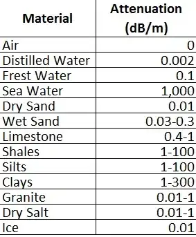

I did find some very basic soil attenuation data at https://archive.epa.gov/esd/archive-geophysics/web/html/ground-penetrating_radar.html. Here is an extract of attenuation in the 40 to 1,500 MHz range:

  • So I was correct, the lower the frequency (longer wavelength) the further it penetrates. Also I noticed it is a bit counter intuitive, but makes sense if you think about it, that if it reflects more (more water content, or harder,denser rock for example) it will penetrate less. – Keith Martineau Jan 05 '18 at 00:50
