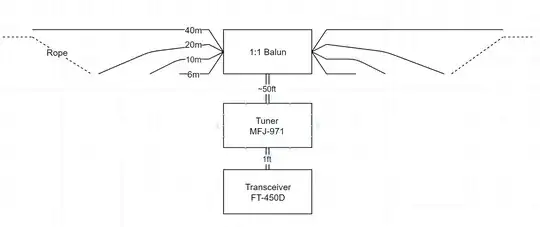

Since I got my HF radio a year and change ago, I've been able to hear very little except noise and the WWV time station on 10MHz. Noise seems to vary by band, but not how I'd expect:
  • 80m: S7-S9
  • 40m: S9+10-20
  • 20m: S2
  • 15m: S3
  • 10m: S9
  • 6m: S5
My setup currently looks like this: enter image description here
My antenna is fairly low above my house, but even killing mains power didn't reduce my noise level by any noticeable amount. I tried plugging in my 2m J-pole and it - being basically deaf on all of these frequencies - had predictable low noise on all bands, with none above S3.
  • The feedline for my 2m antenna has a similar-but-physically-separate path to my transceiver than the HF dipole does.
  • The dipole is only about 15 feet in the air on the low side and 25 on the high side.
  • The dipole, transceiver, and tuner aren't grounded, but any ground nearby would be ~20' from short 5kV power lines that run along one edge of my property. The power lines are parallel to the dipole and the dipole is currently in the only place that I can put it on my property. I've heard that putting ground rods in our soil is miserable and haven't done it yet.
  • I live in a suburban environment.
Does my conclusion that the noise is likely to be coming in through the antenna make sense? Should grounding make a difference? What steps can I take to try to mitigate the noise?

    When I set up parallel dipoles I usually put up only 80 and 20 on one balun. Not sure if that matters here. As for grounding, are your transceiver and tuner grounded? Also, are you sure you are getting clean power? – SDsolar Sep 02 '17 at 00:32
    Have you checked that the antenna is at least a good match on every band? If you have a fan dipole with an element for each band, you shouldn't need the tuner. – Phil Frost - W8II Sep 02 '17 at 02:39
  • @SDsolar - I only have room for one big antenna, so it had to cover the bands I thought I could use reasonably.
    I think it's fair to assume that either my linear PSU or battery would provide clean power. Maybe it's not?
    – William Sep 02 '17 at 19:55
    @PhilFrost-W8II - It's not a good match yet. I cut it long on each band with an intent to trim it later, so I'm using a tuner in the interim. It gets to about 3:1 on 40m and 2:1 on 20m. – William Sep 02 '17 at 20:02
  • @SDsolar - And no, my only station ground is DC to the power supply. Should that matter? – William Sep 02 '17 at 20:03
  • 3:1 is conventionally considered to be too much. Less than 2:1 is the target. But I see @Phil's point. I believe he is wondering how close the antennas are all by themselves. I think I would extend his remark and say that perhaps you might want to try each individually before putting them together. – SDsolar Sep 03 '17 at 01:29
  • Ground at the power supply is fine, as long as the cable to the transceiver is good. But you might want to also consider grounding the tuner to the transceiver. If nothing else, it can prevent you from getting an RF burn from a hot chassis. It may or may not affect the actual tuning. – SDsolar Sep 03 '17 at 01:31
    @SDsolar - Okay, I've connected my tuner ground to my transceiver ground. Thanks for the tip. – William Sep 03 '17 at 01:59
  • Good deal. Let me amplify the other part of what @Phil said - and it matches my experience - that when the antennas are tuned well then you shouldn't need a tuner. (With one exception - when you are using the 40-meter antenna on 15 you definitely need the tuner) – SDsolar Sep 03 '17 at 16:17
  • @SDsolar - I get that I shouldn't need a tuner once the antenna is tuned properly, but "my system is completely deaf due to noise" seemed like a more pressing issue. – William Sep 03 '17 at 17:18

Some troubleshooting ideas:
  • Check your radio's power supply for noise by substituting a battery and disconnecting the PS from the wall.
  • Run your receiver on a battery and turn off your main breaker. Make sure any battery powered computers/tablets are fully powered off. If the noise reduces, turn off all branch breakers, turn the main breaker back on, and one by one turn on the branch breakers noting any change in noise.
  • Install an additional 1:1 balun close to your radio. This sometimes helps prevent local noise pickup on the coax outer shield.
  • Check your coax for any open or marginal connections - especially the shield connections. Try substituting other coax.
  • Eliminate the tuner and short patch coax and note any change in noise levels.
  • Take your transceiver to a location in the country with a portable antenna and running off batteries to eliminate receiver problems. Alternatively take it to another ham's QTH that isn't suffering from noise to check it.
  • Borrow or rent a battery powered spectrum analyzer and walk your QTH and the neighborhood sniffing for RFI with a small dipole or loop.
  • After eliminating all other possibilities, call the power company and let them know you suspect a cracked insulator or bad transformer is causing RFI. They have techs that specialize in these sorts of problems.
Glenn W9IQ

  • All good suggestions, but I would only add that if a balun is at the radio then ladder line would be best for the feedline, as it would then be balanced - and I would then use a 4:1 balun. – SDsolar Sep 03 '17 at 15:38
  • @sdsolar With a proper 1:1 balun at the feedpoint shown by the OP, ladder line has little advantage over coax for a fan dipole. Even with ladderline, asymmetric routing can induce CMC. – Glenn W9IQ Sep 03 '17 at 17:55
  • @GlennW9IQ The feedpoint Z on some bands might be in the thousands of ohms. Therefore, ladder line might have an advantage on some bands. – Mike Waters Sep 03 '17 at 20:29
    @mikewaters Not with a fan dipole on the bands for which their is a dipole element. – Glenn W9IQ Sep 03 '17 at 20:54
  • @GlennW9IQ Duh! Thanks for correcting me. – Mike Waters Sep 03 '17 at 20:59

You wrote "The power lines are parallel to the dipole " and you allow that to pass "OK" because " the dipole is currently in the only place that I can put it...".
In theory , you are inviting inductive linking between your dipole and the power lines.
To wit: I have used a End-Fed Long-Wire of 188 ft , at a height of 17 ft with power lines on three sides, all within 30 ft of antenna.
Antenna design here at K4KKQ : Long-Wire is 188 ft, odd quarters for 40M and 20M.
Long-Wire is up 17 ft, odd quarter for 20M. Long-Wire is angled like letter "Z" and all sides are angled aprox. 45 degrees from power lines.
Connections : Use a 1:1 current balun. Use 50 Ohm coax directly to balun. Use QRP antenna tuner to coax , from the QRP transmitter. Band Noise is measurable at all times, in low "S" units.
Results: Worked all Europe and all states on ONE Watt CW, 20 Meters. Work 1000 miles to New England each weekend, on 20 Meters.
Conclusion: "power lines are parallel to the dipole" and "Linking" and that is why you are getting into such high Band-Noise.
Glen Ellis, K4KKQ

Can you
  1. Turn off all the power in your house
  2. Plug the radio into a battery source (i.e Car 12V) You only need to Rx so no massive power requirement.
Now listen... is this better or the same.
As there (should) be no noice coming from a 12V DC source, if you have noise there are 2 possibilities
  1. Your Transceiver is broken
  2. Your Ant/Env is faulty
Following the House 12V ... can you move the radio to some place like a park/countryside and listen again only connected to 12V (if in a car - this means turning off the Engine). You will need a simple antenna.
If there is still S9+18 it is time to visit the radio repair shop.

  • William - sorry I overlooked that. Then as others have posted your Dipole is too close to the 5Kv power lines. You may want to measure the EMF from this http://www.emfields-solutions.com/detectors/pf5-emf.asp would be one tool (I have never used this). Where do you live ? And could you simply call the power line company to see if there is something they can do/assist you with. The ARRL has some info http://www.arrl.org/power-line-noise I am not sure how applicable this is too you. – Tim Seed Nov 02 '17 at 21:45
  • I've worried about this, and am thinking to purchase a multi-band vertical once the wallet can stand it. I don't see any other way to get around the power lines being so close. – William Nov 03 '17 at 03:00
