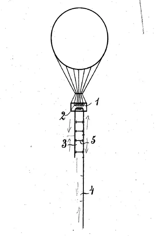

I'd seriously consider the 1909 predecessor of the J antenna by Hans Beggerow. It is, indeed, an antenna designed to hang below a balloon.
Like the modern J antenna (aka J-pole) it is a half-wave single linear conductor fed with a quarter-wave parallel wire transformer, fed in turn near or at the closed end of the transformer. With your payload/electronics package as small as it is likely to be, you can probably get by without the spiffy link coupling and figure out a simpler solution. I'd start by breaking the shorted end of the transformer, flay the feedline and just feed it there. If the impedance is too low, re-short the transformer, run some RG-174 down the transformer line a bit and find the sweet spot... just like a J antenna.
All together this will be about 15 meters in length for the 20m band, but that half-wave wire can be very thin. This will whip around a bit, but I suspect the mass of the wire will tend to keep things reasonably plumb at most times.
If you can find it, super thin 300 ohm twin lead parallel transmission line will serve as the 5 meter quarter-wave transformer.
Best of all this needs no additional counterpoise (or equiv.) to operate as an efficient half-wave radiator. Plus there are no concerns of coupling from the high voltage end of the sleeve to the feedline in a coaxial sleeve style antenna.
With some planning and design you might be able to position your payload/transmitter directly at the feedpoint sweet spot by attaching it to the quarter-wave transformer at that spot. In this way the entire payload (antenna plus electronics) attaches to the balloon at the shorted end of the transformer. The potential problem is the higher voltage portion of the quarter-wave transformer wants to be well away from other conductive or dielectric materials. Still the "50 ohm" feedpoint isn't too far down the transformer so this might be viable.
A link to the patent (in German) along with other references is available on the J-pole antenna Wikipedia page.
https://en.wikipedia.org/wiki/J-pole_antenna
If it was good enough for 1909, it's well worth a good long look now.
