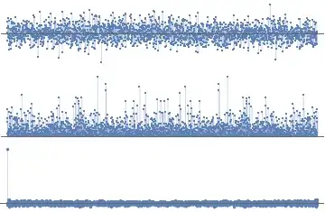

Here are a few examples to illustrate the autocorrelation/power spectrum approach. In the images, I plot the signal first, then the power spectrum, then the autocorrelation. These are simulated signals with sampling interval $\Delta t = 1$.
White Gaussian noise
Flat power spectrum, autocorrelation has a peak at zero lag, flat everywhere else. white Gaussian noise

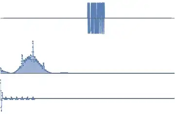

Barker-coded pulse
Radars use these to reduce their peak power requirements while maintaining range resolution. $\sin^2 \omega/\omega^2$ structure due to the pulse shape. Autocorrelation shows a narrow peak at zero lag. In the wild, these pulses are much shorter than I show here, leading to flatter, wider spectra. They can be difficult to distinguish from noise unless you have some independent way to calculate the SNR in the channel (which is difficult if you don't actually know that there is a signal in the channel). Best to just look directly in the time domain.
Barker-coded pulse

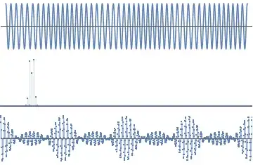

FM with sinusoidal modulation
Easy to see in both the power spectrum and autocorrelation.

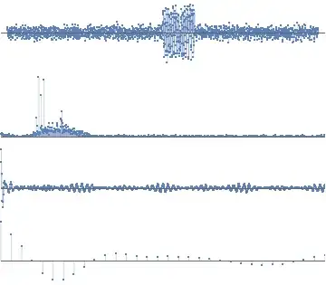

Sum of all three
Here I've set the noise $\sigma = 1/4$, the peak amplitude of the pulse to $2$, and the peak amplitude of the FM signal to $1/4$. The fourth plot is a close-up of the autocorrelation near zero lag.
Sum of noise, pulse, and FM signal
