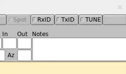

That's a Reed-Solomon identification (RSID). It's purpose is to tell other stations what mode you are using. For PSK it's usually pretty obvious.
To disable it, look for the "TxID" button in the upper-right of the window, and click it to toggle it on and off.
(As you might imagine, the RxID button toggles the receiving of RSIDs. When it is enabled, Fldigi will tune the receiver and switch to the correct mode automatically when it hears one.)
