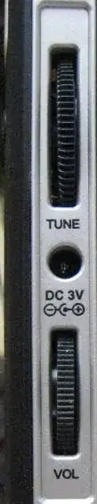

It looks as if the Eton Mini needs a 3 volt center-positive power supply. It's probably 3.8 mm OD, 1.4 mm ID barrel connector, but that's just a guess based on the half-inch depth specification of the radio:
Picture of jack side of radio
Since it lasts you two days on two AAA batteries (probably 1000 mAh) you can probably get by with a minimum 0.1 A (100 mA) power supply. A little more would put you on the safe side, and 1000 mAh / 1 Ah would be overkill but sure to work.
Any generic power supply with the right connector, voltage, polarity and amperage will work. (Power supplies with higher amp ratings will also work, but beware of power supplies with higher volt ratings.) The adapter plug's connector outer shield will need to touch the metal on the inside edge of the socket connector on the radio, and the adapter's inner connector will need to make contact with the pin inside the socket's connector on the radio. Barrel connector sockets can accommodate plugs of slightly different/incorrect sizes in a pinch.
Anything that advertises itself as compatible should work fine - there's nothing fancy about the power supply.
