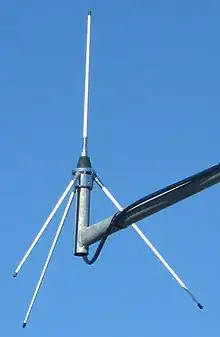

However, the "ground" need not be Earth. It can simply be some elevated conductive wires or tubes:
vertical with elevated radials
Here, the three sloping tubes are the "ground". Drooping them results in a better match to 50Ω coax.

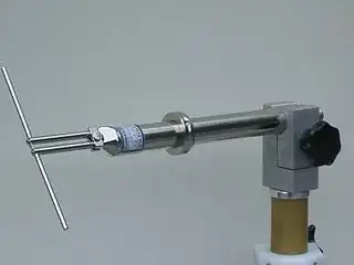

There are of course many antenna designs besides monopole antennas. Here are just a few, none of which require any special ground to operate:
dipole
dipole
