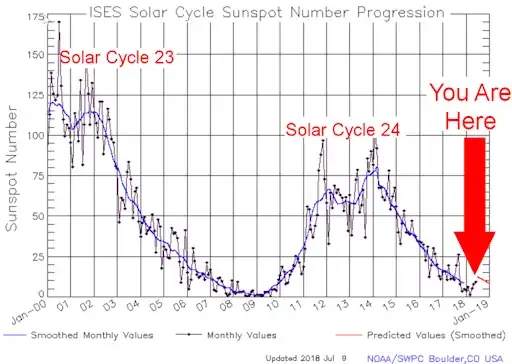

According to this chart, 2016 was not the solar minimum. We appear to be at or very near the minimum right now. However, we won't know for sure until some more time passes.
Yesterday on spaceweather.com, the following information appeared:
THREE WEEKS WITHOUT SUNSPOTS: The sun has been blank for 21 days--3 whole weeks without sunspots. To find an equal number of consecutive spotless days in the historical record, you have to go back to July-August 2009 when the sun was emerging from an unusually deep solar minimum. Solar minimum, welcome back!
Space weather forecasters have long wondered, will the next solar minimum (2018-2020) be as deep as the previous one (2008-2009)? Twenty-one days without sunspots is not enough to answer that question. During the solar minimum of 2008-2009, the longest unbroken interval of spotlessness was ~52 days, adding to a total of 813 intermittent spotless days observed throughout the multi-year minimum. The corresponding totals now are only 21 days and 244 days, respectively. If this solar minimum is like the last one, we still have a long way to go.
At the moment there are no nascent sunspots on the solar disk, so the spotless days counter is likely to keep ticking. Stay tuned for more blank suns.
