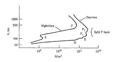

As you are probably aware, solar radiation ionizes atoms and molecules in the atmosphere at altitudes of about 50 km or so and above. The densities of free electrons produced vary from between a billion and a trillion electrons per cubic meter, depending on altitude and time of day (see below).
Different regions of ion density are identified with letters (D, E, F), but the boundaries between regions are not that clearly defined.

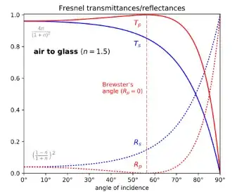

A complete description of how the wave gets reflected is provided by the Fresnel equations, which include expressions for the amount of energy reflected by waves that are polarized perpendicular and parallel with respect to the reflecting medium. An example of the Fresnel reflectance (and transmittance) is shown below for a wave traveling in free space and impinging on glass, with a permittivity 1.5 times that of free space:

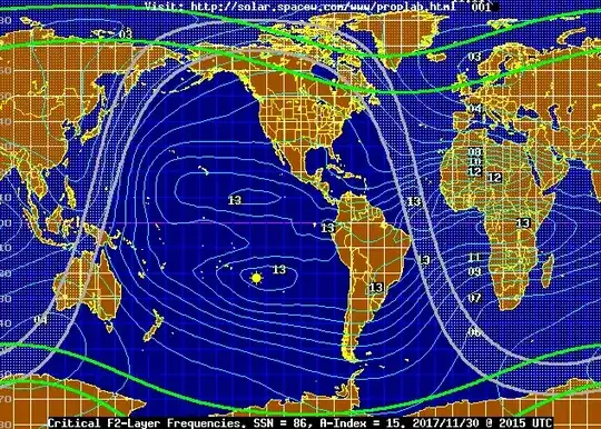

Some definitions of MUF are in terms of the the channel being available over some percentage of the month at a specific time (e.g. 90%). A common rule of thumb is to estimate the MUF at about 3 times the critical frequency.
The map below (from spacew.com) shows a contour of F2-layer MUF's (in MHz) by location for the time and date indicated (302015 UTC Nov 2017):
