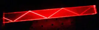

Skywave propagation is closely related to total internal reflection. This is easily demonstrated with visible light (which is also electromagnetic radiation) through a block of acrylic:
Total internal reflection occurs when the angle of incidence is above a critical angle, which is a function of the refractive indexes of the two materials:
