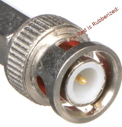

While inspecting a male BNC connector we noticed that there is a rubberized gasket in the back that the female side presses against tighly when latched. I checked all the male connectors that I had nearby and they all had the gasket:
Male BNC with Rubberized Seal

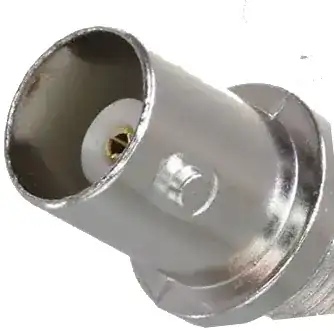

Looking at the female side, a touch of dielectric grease on the outer metal ring to mate with the gasket should keep water out (and indeed, the grease might not be necessary).
I've looked around and while all pictures seem to have this gasket, I have found no reference to BNC connectors being rain/waterproof by design even though it appears as though they might already be rain-proof. (There do exist rain-proof connectors that address the cable interface, but in this question I want to know if it happens that the connection itself is already rain-proof by design.)
Does anyone know for sure?

According to the BNC spec, connectors are only required to pass "moisture resistance" test MIL-STD-202(Method 106) whose specific purpose is:
The moisture resistance test is performed for the purpose of evaluating, in an accelerated manner, the resistance of component parts and constituent materials to the deteriorative effects of the high-humidity and heat conditions typical of tropical environments.
Since there are so many different idiosyncratic definitions for "rain, resistant," I'll leave it to you to interpret what that means for your locale and use case.
Related, many vendors sell BNC connectors that are also IPX rated (an environmental resistance standard).
