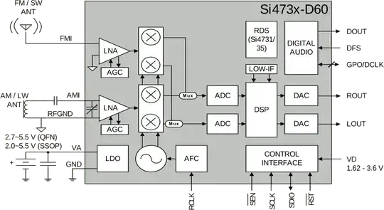

For example, the Si4735 I mention above has this architecture:
From the datasheet linked to above
That doesn't look like a classical superhet to me! (It actually is a superhet, of kinds, because this is a low-IF $\eqref{1}$ quadrature mixer, but it's not using the architecture for the same reasons you usually use a superhet, and hence, the filtering is different, slightly.)
(You can find an example schematic of how to build the full multiband receiver on page 18 of the datasheet I've linked to above. Antenna matching, and audio amplification, nonwithstanding, that's 1 Receiver IC, 5 passives, and a microcontroller that speaks I²C to control the receiver. I'd actually say: you could build that radio you have yourself! (It's also

In reality, for the last ca 2 to 3 decades, integrated receives will simply sample the IF with an ADC and then have a digital IF or equivalent complex baseband signal to do the rest of the processing.
So, in general, you can't claim that. A product detector, or any combination of these two principles, is equally likely. Since we're doing this on an IC, honestly, the product detector might even be easier (no nonlinear function, less filtering, just a multiplication with a digital oscillation).
That's also where the PLL might come in. It's generally useful to have a PLL to lock onto your transmission's carrier, right, so that you don't have to tune as precisely, and so that oscillator drift doesn't make your reception worse over time.
If you have a PLL, then you already have the thing that generates the oscillation a product receiver needs.

As said above, I don't know which chip your radio is using, but if that chip happens to be architected the way the Si473x is: yeah, but no!
There's a phase-locked loop, but it's likely controlled from further down the receiver chain, where you have the filtered signal, already, and hence get a better SNR. It's a digitally-controlled / generated oscillation, and not something attached more or less directly to the antenna. And as mentioned, low-IF, not usually baseband. (Baseband comes with many problems for such receivers, namely DC offset and problems with phase and amplitude uniformity in the lowest frequency components. For bandwidths so trivially low, it's easier to have an I and Q, which are not actually baseband. (works really the same as the direct conversion quadrature mixer, just that you don't mix to 0 Hz, but a bit above. In the case of LW reception, you'd actually mix up, most likely, not down ;) )
