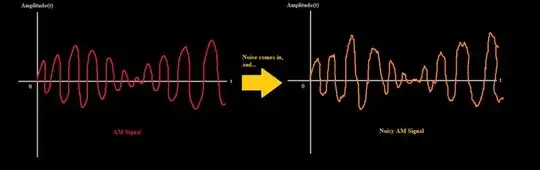

Noise effects on an AM signal
As a result of the superposition theorem, that noise directly affects the amplitude envelope of the modulated wave which means distorting the message from the first hand. Thus, on the receiver side, the SINAD (signal-to-noise and distortion ratio) is aggravated.

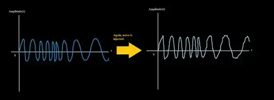

Noise effects on an FM wave
As it can be seen from the drawing, although the noise slightly changes the amplitude of the FM signal, the frequency change of that wave is the same. So, the SINAD on the receiver could be much higher than that in the AM transmission scenario which increases the quality of the overall communications environment.

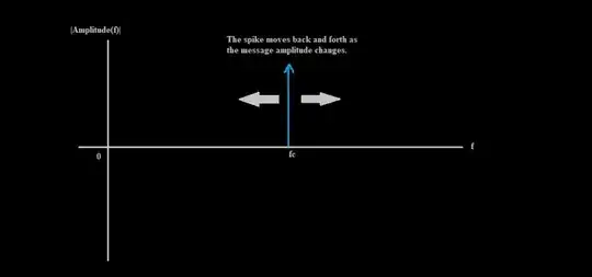

An FM signal in the frequency domain
The above figure shows the ideal (theoretical), one-sided magnitude spectrum of the FM signal $b(t)$. By changing the carrier frequency, the Dirac delta moves on both directions. This may be useful in avoiding a specific jamming signal component in the spectrum. But, the spread spectrum technique is a different topic which utilises rectangular pulse signals (here, digital systems come into play) and coding. Very briefly, by resorting to the relationship between temporal-spectral information when expanding-compressing signals in the time domain, the spread spectrum can be achieved.
