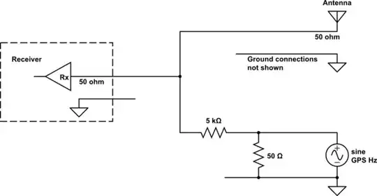

What you need is a crude splitter (or combiner, same thing) with a very unequal ratio.
I suggest something like this:
schematic
simulate this circuit – Schematic created using CircuitLab
Here the signal generator voltage is attenuated by about 100 x (40 dB) and the antenna signal is not attenuated at all. Normally a splitter would have resistors in all the paths, to maintain 50 ohms everywhere, but in this high ratio case you can easily work out that the matching is not compromised much by the parallel connection of the two paths. An equal fraction of the reference signal will also leak out of the antenna, but at these levels it should not matter.
You might find that 40 dB is not enough - in that case you will probably need to add SMA attenuators to the reference signal source, rather than increasing the value of the 5 k - the capacitive coupling in the board will leak at the -40 dB level anyway. It might not matter too much if the GPSDO signal is a lot stronger than the signal on the air, the AGC will adjust the volume. There's even a small benefit in that you won't have to switch, just let the reference tone dominate, when it's on.

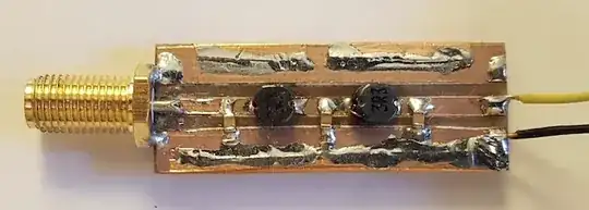

Construction can be as messy as you like, but being careful with the ground will improve the isolation. Here is an example of a low pass filter I built recently - plain copper-clad PCB, copper tape and a sharp knife. You could adapt this to have three SMA connectors.
RF PCB.

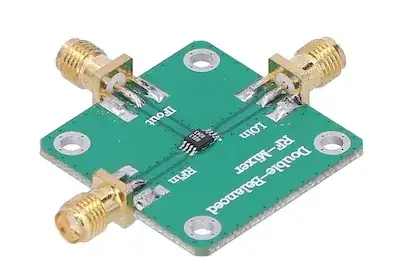

You could also buy a small RF splitter / mixer board on ebay and modify it to build the combiner you need:
