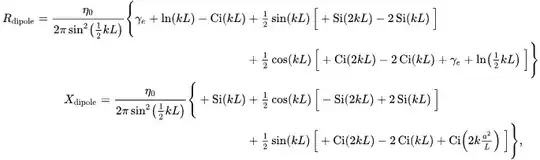

The impedance of a half wave dipole can be calculated by these next two formulas, where it's clear that self inductance is a determining factor.
$L$ is dipole length, $a$ is the radius of the conductors, $k$ is the wave number $\frac{2πf}{c}$, $η_0$ denotes the impedance of free space = 377Ω, and $\gamma_e$ is Euler's constant = 0.57721566
