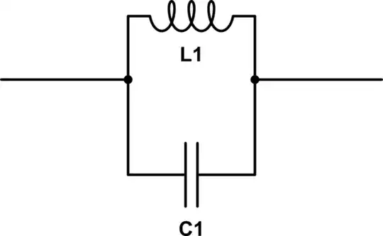

In practice, you can't build this; perfect filters aren't possible. Instead, we use a parallel inductor and capacitor to build a series bandstop filter, and call this an "antenna trap". As a loose circuit, it looks like:
schematic
simulate this circuit – Schematic created using CircuitLab
Note that the trap is symmetric, and you change the component values to choose the resonance point; I'll leave the proof as an exercise, but resonance happens when $f = \frac{1}{2\pi\sqrt{LC}}$.

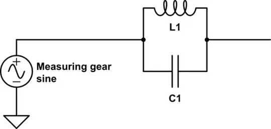

When you measure the trap on its own, with one side left unconnected or shorted to the measurement gear's ground reference, and your measurement gear connected to the other side, you will see a very high VSWR away from resonance (where the filter's series impedance is irrelevant, and you're seeing the impedance you'd see if you replaced the trap with a small piece of wire), and it'll drop at resonance, where you're seeing the impedance of the trap in series with the open circuit or short to ground at the other side of the trap, then climb again as you move away from resonance. However, the dip is not guaranteed to be down to 1.0:1 - it could be to 8.0:1 quite easily. You might, for example, see that VSWR is 10:1 from 3.5 MHz to 6.5 MHz, falls to 8.0:1 at resonance, and then climbs back up to 10:1.
With the far side left unconnected, the resulting circuit you're measuring looks like:
schematic

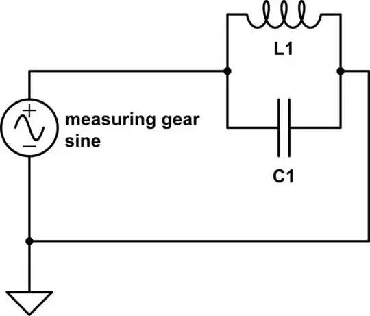

With the far side shorted to ground, you get:
schematic

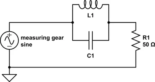

If you terminated the far side of the trap with a 50 Ω dummy load (a pure resistance) connecting the far side to the measurement gear's ground, the trap's behaviour as measured on your SWR meter will change; as you get further from the resonant frequency, the VSWR will get close to 1.0:1, while as you get closer to it, the VSWR will increase to indicate the inherent high impedance the notch filter presents at its resonant frequency. So you might see 1.1:1 at 3.5 MHz and at 10 MHz, and 7.0:1 at resonance.
Measuring with a dummy load makes the circuit you're measuring look like:
schematic
