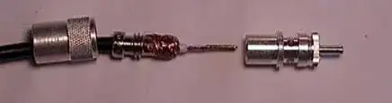

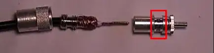

It looks like you may be trying to solder to the reducer rather than the actual connector. If that is the case, try soldering to the connector through the openings in between the threading designed for the screw cap.
PL-259 Connector Soldering guide
