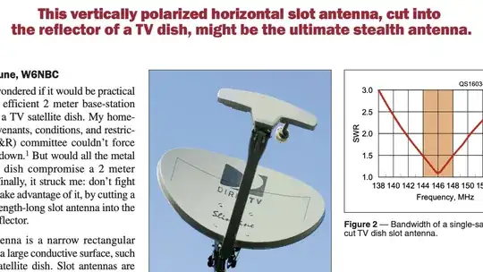

A fun vertical antenna can be made by cutting a horizontal slot in a satellite dish, as documented in e.g. http://www.w6nbc.com/articles/2016-3QSTdishslot.pdf and discussed in How does a slot antenna work? and other questions here. But how would this modification affect the original (satellite receiver) antenna system?
Screencap of linked PDF highlighting picture of a DirectTV dish with an open rectangle slot cut in it
Of course, trying to use both antennas simultaneously would run into practical concerns — aiming of the dish necessary for satellite reception vs. what would be ideal for a station's desired 2m pattern, whether the LBNF and/or satellite receiver would appreciate being party to a 25W ham signal, etc. But all the same, I'm curious if/how the slot affects the parabolic reflector itself.
I know that a reflector needn't be completely solid, and can work with a metal mesh or even a wider grid/skeleton of wires. So is a narrow slot — surprisingly effective at its own VHF frequency — also totally insignificant at the EHF frequencies? Or does a long continuous hole affect the aperture efficiency more than losing equal surface area via small disconnected holes would affect it?

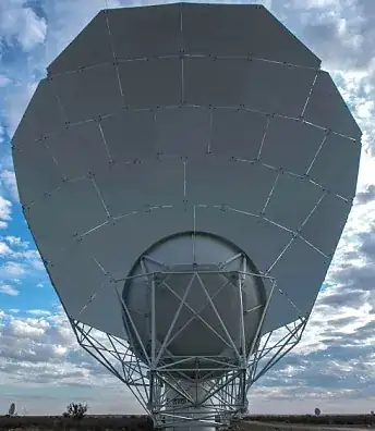

The MeerKAT antennas have ~ 5 mm gaps between their panels. Here's a backlit photo from the daily mail / AFP / Getty
There's a small amount of noise leakage, not enough to justify covering the gaps.
