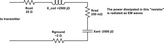

Some calculations about the power loss:
(edit: typed in formulas, redone calculation in metres, all the numbers change slightly)
110 uH at 80 m (3.5 - 3.8 MHz) has a reactance of ~2500 ohms.
I look up two useful formulas at antenna-theory. Note:
  • We are definitely in Short Dipole territory here, length << wavelength, so the current distribution is triangular (if you like, the very end of a sinusoid, the part where sin(x) ≈ x )
  • Remember all these are for dipole antennas so the length and impedance is double that of the monopole case.
First, the reactance, to match that of the coil:
$$ X_{dipole} = {{-120\lambda}\over{\pi L}}\left( \text{ln}\left( \frac{L}{2a}\right)-1\right) $$
Experimenting a bit (I can't solve it) I find a 4 m long dipole of diameter 4 mm has about -5000 ohm reactance, i.e. -2500 ohms on a 2 metre monopole, which will resonate with that coil, and is a reasonable whip length for a vehicle. So you're probably making a base loading coil for a whip antenna (this is just me reverse-engineering the intended application).
Knowing the antenna type and length we can estimate the radiation resistance (on a perfect ground plane):
$$ R_{rad} = 20 \pi^2\left(\frac{L}{\lambda}\right)^2$$
The radiation resistance of a 4 metre dipole on 80 m is 0.5 ohms, so the monopole antenna will be about 0.25 ohms and there will be a few ohms of ground loss.
The coil Q might be as much as 100, to be generous, meaning it will have a resistance of 25 ohms.
Now I can draw a circuit model of the whole antenna:
schematic
simulate this circuit – Schematic created using CircuitLab
The series circuit of coil loss resistance, radiation resistance and ground loss, shows you that over 90% of the power is lost in the coil, depending on the size of the vehicle and the type of ground, more likely 99%. (you can estimate the coil Q just by looking at the bandwidth of the antenna when it's tuned).
So you need to plan for the coil to dissipate 100-200 watts without catching fire or getting out of shape. This also means that less than 1% of the power is radiated. This is the unfortunate reality of mobile HF antennas, especially for 80 m.

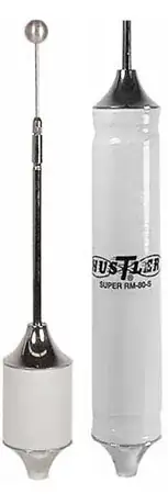

There are ways to raise the Q of the coil to several hundred - making it a larger diameter, thicker wire, keeping metal away from the ends, and using a ferrite core. It's also more efficient to put the coil halfway up, as Hustler does. These can dramatically improve the transmitted power, but you can see they won't make a big difference to the power dissipated in the coil.
Here's an example of a commercially available resonator for 80 m, capable of "1000 W" (right): hustler
From memory, the Hustler RM-80S is about the size of a 0.5 to 1 litre water bottle.
So for 600 W, you probably want your coil to be about half this size.

    @ThomasDK3TU because that's how short it would have to be in order to require a 110uH coil for resonance, based on taking a known X and solving for L in the last formula on the page. I was thinking something similar myself, but didn't include it in my answer because I didn't have the numbers on hand, just a general feeling of "that's a lot of inductance for 80m, it can't be an efficient antenna". – hobbs - KC2G Jan 26 '22 at 15:40
    The RM-80S coil is 2.5" diameter (to the outside of the enclosure, so probably 2" for the coil) and around 10" long. It's the whip that adds another 48" or so. – hobbs - KC2G Jan 26 '22 at 15:46
