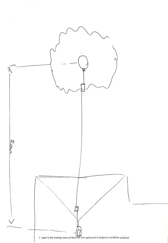

Trying to avoid putting up large structures on roof, and utilise nearby Chestnut tree on edge of property. My current simplest idea is a fan dipole, with some concerns/buts (see below)... Some sketches:
Side view looking towards ENE: enter image description here
Top View: enter image description here

I have only shown some end-insulators on a single dipole with coax centre feed into a 1:1 balun. Basic plan is currently for a fan dipole to get reasonable resonance in each of the bands.
  1. Unless I butt right up to the tree and the roof, I probably won't have room for a 40m band half-wavelength dipole. The length from end of roof ridge to fork in tree is just over 20m. There might a possibility of attaching to the other top ridge running ENE (ref sat image), which would give me the extra length but put a significant part of the antenna length over the roof.

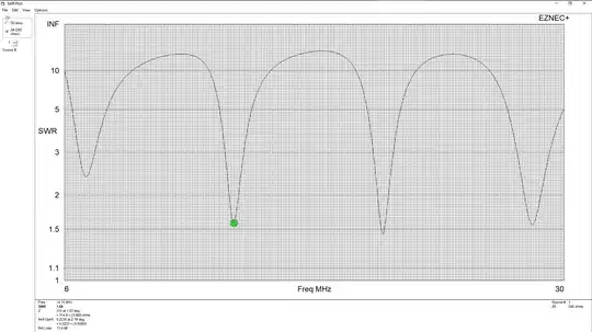

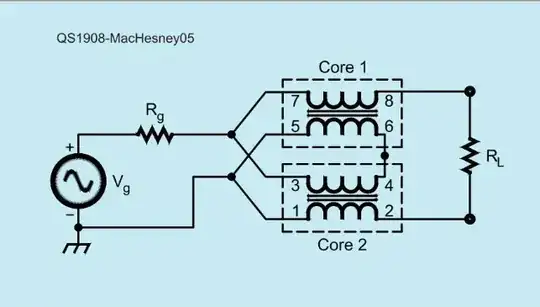

Here's the SWR curve for a half-sized "Slightly Off-Center Fed Dipole" described in the September 2019 issue of QST magazine:
The antenna provides an SWR on your bands of interest that any rig's built-in matching network should handle with ease and mismatch losses in a modest run of coax should be minimal.

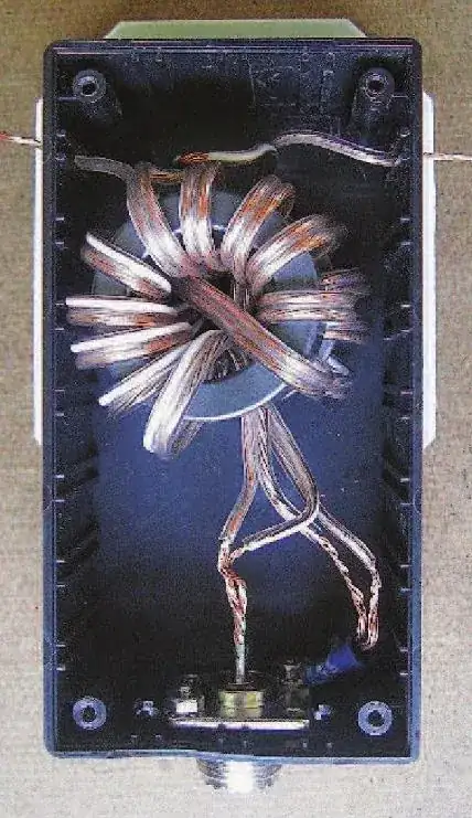

Notice that the SWR is calculated for 200-$\Omega$ characteristic impedance. The wire is 20.9-m long and is fed 40% from one end through a 200-$\Omega$:50-$\Omega$ balun for convenient coax feed. (Note: not a typo, this feedpoint is slightly different from the article.) As the author of the original article I received dozens of letters, some of which claimed success with a variety of balun designs, but I recommend a two-core Guanella type "current balun":
with a choke of coax turns on a ferrite ring below but near the balun to prevent common-mode current on the outside of the coax shield.
Because the feedpoint is not far off center, it's possible this balun is somewhat over-designed, but the parts are relatively inexpensive and readily available. I wound the balun for the article with two-conductor speaker wire to illustrate the utility of low-cost, everyday items one might find lying around the house:
It's abundantly possible that, with sag, the entire wire will just fit in the 20-m space between your house and tree. But, if it doesn't, "drooping" the far end of the wire will have very little effect on the antenna's behavior.
Brian K1LI
