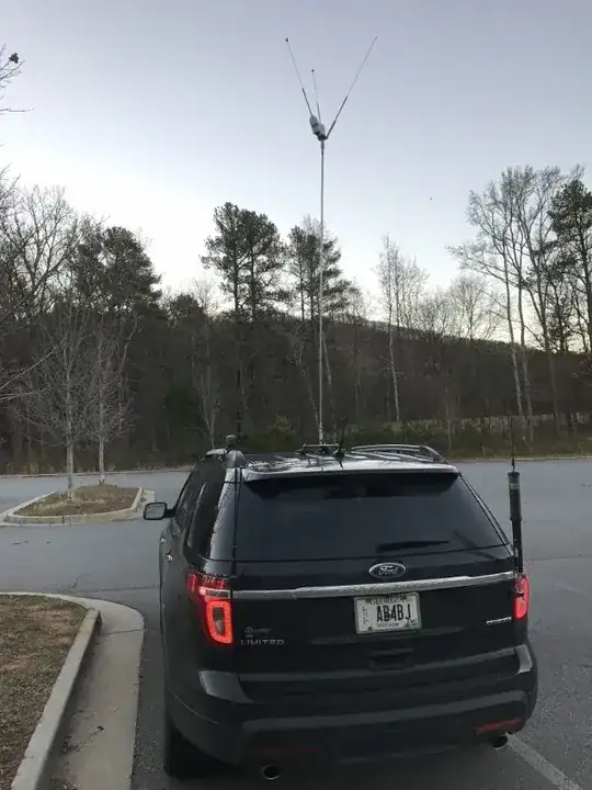

Some photos & a description of an antenna like this are at https://ab4bj.com/wordpress/2017/01/ab4bj-portable-antenna-system/
One photo from the above-linked site

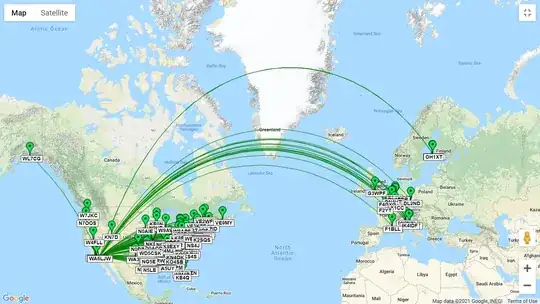

I'm a very active park activator within the WWFF and POTA park activity. The one thing that I vowed that I would never do is put up an antenna with radials, or wires as most of the parks and beaches out here in California are very crowded, especially during the summer months. I chose to use 4 Hustler resonators on 1 mast. A good friend of mine, Tom,KG8P machined a plate for me. I mounted a 40, 30, 20 and 17 meter resonators on it. I drive a Honda Odyssey SUV which has a metal roof. I tuned the resonators for the CW portion of the bands using an MFJ-259J antenna analyzer. I mount the antenna via an MFJ-336S mag mount. I have had fantastic results. My Yaseu 891/FC-50 combo tunes perfectly on all bands. I have had European pileups during my activation's. One note... I DO NOT DRIVE WITH THE ANTENNA MOUNTED ON THE ROOF. This combination works. de W6LEN / Jess enter image description here
