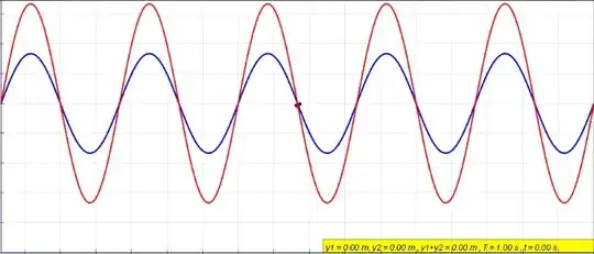

    @Derpy how's this for a start? – hobbs - KC2G Oct 27 '20 at 06:02
  • that really helps! I think I'm gonna have to really study superposition. For example, if you have two different frequencies that come in phase periodically, doesn't that destroy the original amplitude (AM radio)? How does AM radio work when other frequencies can influence the amplitude when they align in phase? – Derpy Oct 27 '20 at 14:50
  • So basically the tuner is resisting anything that charges or discharges at a different rates? I can see it on the website. That really helps a lot. I can see it struggling so it's not a perfect output. – Derpy Oct 27 '20 at 14:56
  • I can see how the original frequency stays when other frequencies are out of phase. The bumps are still there but with other peaks and valleys in-between. The thing that confuses me is in-phase. You can have multiple different frequencies that go in phase with a specific frequency. The original amplitude is destroyed. – Derpy Oct 27 '20 at 15:15
    @Derpy any other frequency can't stay in phase, and if it's a significantly different frequency, it passes through being in phase quickly enough that the filter doesn't react very much. The closer the frequency is to the desired frequency, the longer it can maintain phase coherence... which is why filters have roll-off. – hobbs - KC2G Oct 27 '20 at 15:34
