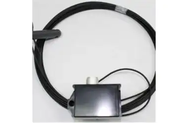

How should a coax-to-housing connection like this be weatherproofed? It doesn't seem like taping is going to do much good here
balun housing with SO-239
Brad Mace
  • 411
  • Why wouldn't taping work? Do you have a more clear picture? – Phil Frost - W8II Sep 24 '20 at 03:41
  • Rubber plumbing tape comes to mind – Tony Stewart EE75 Sep 24 '20 at 14:14
  • @PhilFrost-W8II my concern is that you're taping from the connector to the perpendicular surface of the housing. It doesn't seem like you'd get a good seal like you would with two cables joined at a barrel connector. But if you all think that'll do it, maybe I'm just over thinking it. or maybe I'm just having trouble visualizing how to wrap the tape for this scenario. – Brad Mace Sep 24 '20 at 14:39

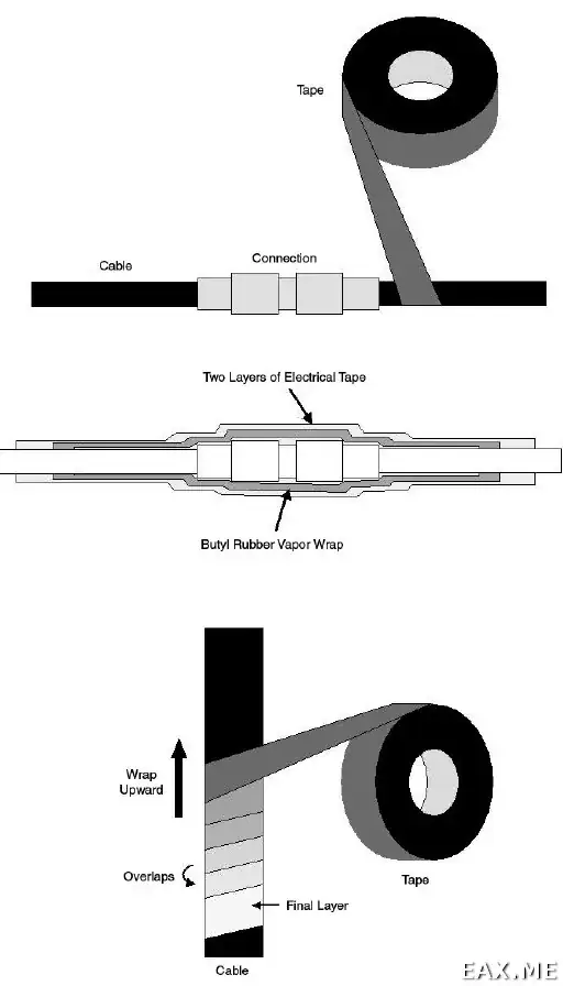

Here is one of recommended methods:
It's from The ARRL Handbook if I'm not mistaken. Personally I use two layers of electrical tape covered with two layers of varnish.
