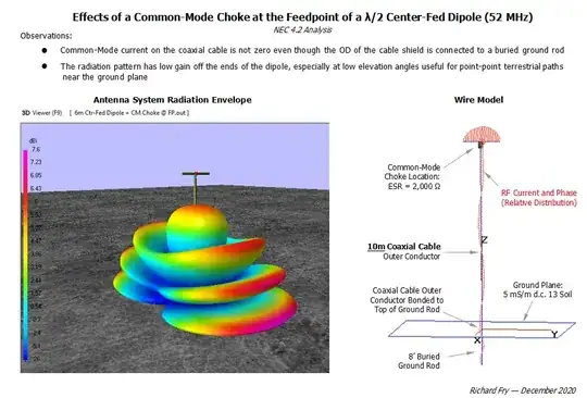

The NEC4.2 analysis below shows the performance of a CM choke at the feedpoint of an elevated, center-fed, h-pol dipole at 10m AGL, and the radiation pattern of that antenna system.
The "observations" in the graphic may be surprising, especially when considering the presence of CM current along the entire length of the coaxial line of that system — even though the OD of its shield is connected to a buried ground rod.
