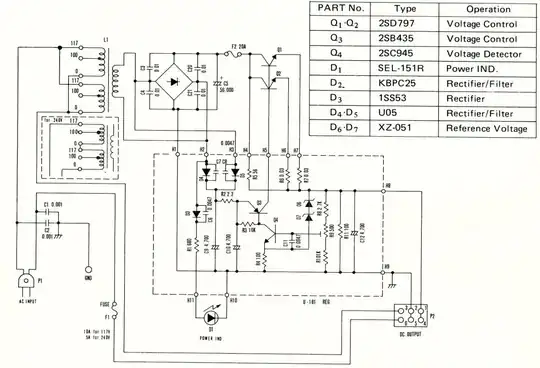

What I am trying to do
Radio is an IC-271, ~ 20 years old. I want to run it with a 12 V lead acid battery. I need to connect the battery to the radio. The radio's DC power connector is a 6-pin molex(?). The radio is designed to be used with power supply IC-PS15. On page 4 of the power supply manual, it shows what the power connector pins are.
Pins 2, 5 are ground. <- I understand this.
Pin 6 is for 110 or 240 V?? <- I don't understand this.
Pins 1, 3, 4 <- I don't know what these are by looking at the diagram.

I assume you're looking at this schematic:
Schematic
Pins 2 and 5 are ground, as indicated by the chassis-ground symbol they're wired to. Since 1 and 4 also come from the power supply's low-voltage side, they must be the +12V output.
Now, Pin 6 is going to the AC power cord, which is odd. But, if we follow the wire on pin 3 that is drawn parallel to it, we see that it goes to the transformer. So, there's a simple explanation for this: this is a circuit that allows the power supply to be turned on or off by a switch on the radio. If pins 3 and 6 are not connected, the power supply gets no power, and if they are it does.
So, there is no need to worry about those two pins if you are supplying battery power — you could wire a switch across them to be able to use the switch that is somewhere on the radio, or you can also ignore them entirely.
(Incidentally, the "110 or 240 V" description is referring to selecting the right current rating for the fuse given the supply voltage; it's not intended as a description of the function of the wire, but it did give you a hint!)

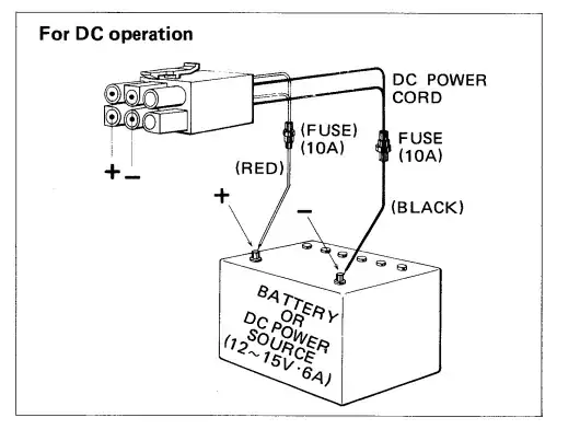

From the IC-271A/E manual, page 3:
diagram of DC power plug
Pins 1 and 4 are both positive (12V or 13.8V or whatever), 2 and 5 are both ground, and 3 and 6 are left unconnected. This is the common six-pin power connector found on many HF rigs (but more recently replaced by a four-pin connector in Icom's case).
