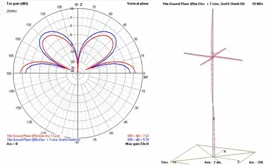

RE: ...understanding...that...ground plane radials are...used to isolate...the metal mounting pole from the antenna and stop the pole from becoming part of the antenna and radiating / receiving.
Unfortunately (for an example), even a set of 4 x 1/4WL radials of a 1/4WL v-pol "Ground Plane" antenna does not prevent r-f current from flowing along the outer diameter of the outer conductor/shield of coaxial transmission line connecting it to the source (the transmitter), even though the coax shield outer conductor is connected to and at the surface of the Earth.
R-F current flowing along the coax shield OD (and/or the OD of a metallic tower/pole etc used to support the antenna) produces e-m radiation into space just as it does when flowing along the vertical conductor of the ground plane antenna, itself.
The following NEC4.2 analysis is an illustration of this. The red lines surrounding the wire model at the right side of the graphic show the relative amplitude and phase of the r-f currents flowing along those conductors.

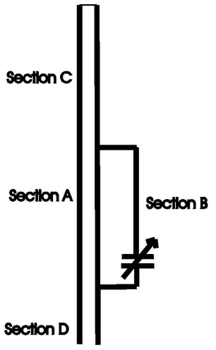

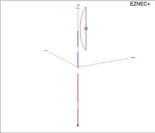

I modeled a $\frac{\lambda}{2}$ vertical dipole located $\frac{\lambda}{10}$ from the top of a grounded $\lambda$ conductive pole. Numerous NEC2 simulations with four (4) $\frac{\lambda}{4}$ and $\frac{\lambda}{2}$ radials at locations up and down the conductive support did meaningfully reduce currents in the support.
Reducing currents in the conductive pole requires breaking it up into lengths that won't support current at the operating frequency. Shown below is the first example that showed meaningful current reduction, requiring the pole to be broken into three sections.
Each of the upper sections is $\frac{\lambda}{5}$ long and they are separated by $\frac{\lambda}{20}$, but the separation was just for convenience in simulation. This can be accomplished with insulators, of course, but also using de-tuning "loops" a la W8JI and others:
Maximizing the current through the capacitor-tuned loop sections A and B minimizes the currents in the adjacent sections C and D.

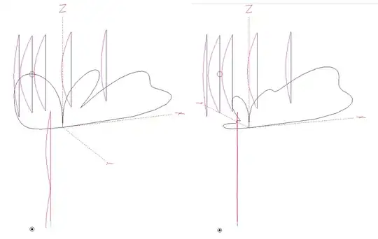

Modeling indicates that there are two steps you can take to reduce the interaction between the antenna and a conductive support:
  1. Remove the conductive portion of the support from the space between the elements
  2. Insulate the support from ground
The image on the left, below, has a conductive element connected to ground; the image on the right does not. Note the substantial current in the support on the left and the near absence of current in the support on the right. The vertical radiation pattern from the antenna on the right loses about 0.25-dB of gain and about 2-dB of F/B compared to the same antenna without the support.
Note that simply insulating a "full length" support from ground does not provide any relief, nor does it suffice to insulate a top section of metallic support from a bottom section.

    Do these conclusions hold for all cases or are they very specific to the mast length selected in the model? – Phil Frost - W8II Apr 29 '20 at 14:55
  • @PhilFrost-W8II I expected a half-wave mast to be the worst, but it shows no current with: the boom at 1 wavelength above ground; the conductive mast protruding a half-wave toward the boom from the ground; regardless of whether the mast is grounded or insulated. – Brian K1LI Apr 29 '20 at 18:03

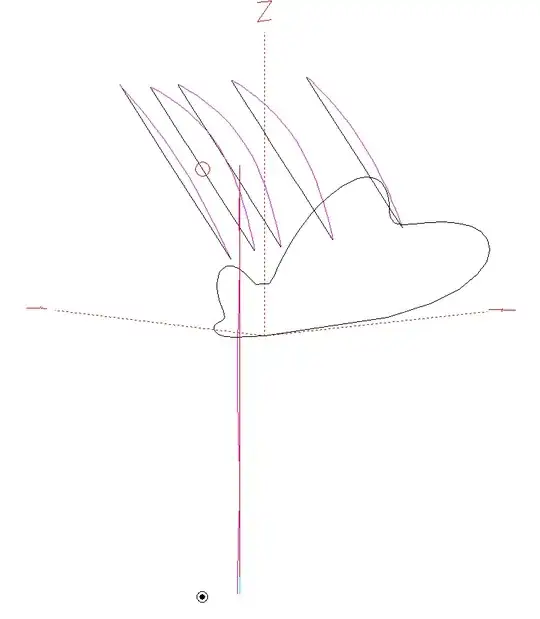

Here is some out-of-the-box thinking: rotate the yagi elements 45$^o$:
The interaction with the (grounded) mast is virtually eliminated, plus the ground-reflection gain at least partially compensates for any polarization loss you might experience.
