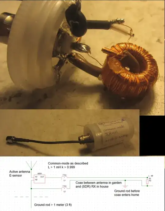

The common-mode isolator helps. For lower frequencies (< 1 MHz) it is almost impossible to have high isolation with just one or more ferrite rings. May be this helps: a common mode isolator specially for high-sensitivity outdoor E-field antennas. See picture. My receiver is RSP1A and/or RTL-SDR and I have not any noise from computer and/or power supply, nor from switch-mode supplies in my house. Remote antenna, free standing, 10 meters coax. Technical info: 3 uH * N^2 for the toroid, so 50 wdg makes 7500 uH. Isolation max 5 kOhm at 2 MHz. Signal loss < 1 dB up to 30 MHz (use twisted Cupper-enamel!). PA0FSBCommon mode interference isolator for SDR connected to noisy supply environment
