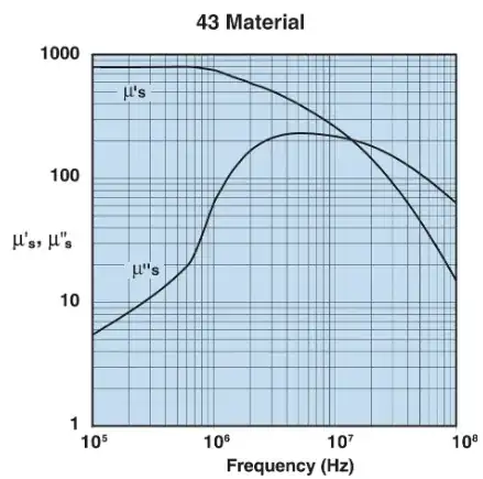

The impedance (Z) of an inductor wound on a ferrimagnetic core is: $$Z=j\omega L_s + R_s = j\omega L_0 (\mu_{s}^{'} -j\mu_{s}^{"})$$ where $L_0$ is the inductance of the winding in vaccuum and $\mu_{s}^{'}$,$\mu_{s}^{"}$ comprise the material's complex permeability, representing a core's lossless reactance and resistive dissipation, respectively. The variation of $\mu_{s}^{'}$,$\mu_{s}^{"}$ for a material vs. frequency is provided by the core's manufacturer:
43 material complex permeability
$L_0$ is calculated as: $$L_0 = \frac{4 \pi N^2 10^{-9}}{C_1}$$ where N is the number of winding turns and $C_1$ is the core's "structure constant" or "form factor". $C_1$ is $\frac{l_e}{A_e}$, the ratio of the effective magnetic path length to the effective magnetic cross-sectional area of the core, physical characteristics that are constants for a given core's geometry. Since all of the parameters are constant, $L_0$ should also be a constant.
Since $L_0$ is a constant for a given core geometry and $\mu_{s}^{'}$,$\mu_{s}^{"}$ are inherent properties of the core material, the shapes of the reactance, resistance and impedance curves vs. frequency should be the same for all cores of the same material, but this is not the case as shown below for two 43-material cores from Fair-Rite:
What is the cause of the differences in the shapes of the two sets of curves?

    But but they're different size cores - one is 19 mm long, the other is 13 mm. Why would you expect $L_0$ to be the same? The big difference happens near 1 GHz where 20 mm is starting to matter too. – tomnexus Dec 11 '19 at 21:06
  • @tomnexus he's not saying that L0 should be the same, but rather that it should only cause a proportional difference between the two cores, and the two curves should be the same other than their heights, because u' and u'' are bulk properties. – hobbs - KC2G Dec 11 '19 at 22:10
  • (The answer, I believe, is "dimensional resonance" but that's not something I can talk about in enough detail for an answer). – hobbs - KC2G Dec 11 '19 at 22:11
  • interwinding capacitance and winding resistance may also not change proportionally as the size changes – Phil Frost - W8II Dec 13 '19 at 19:32
  • @PhilFrost-W8II But, these curves are for a single winding on a binocular core. – Brian K1LI Dec 15 '19 at 15:12
  • Could it be as simple as just "variation between batches"? I am under the impression that batch-to-batch variation can be significant. – Chris K8NVH Feb 11 '20 at 12:57
